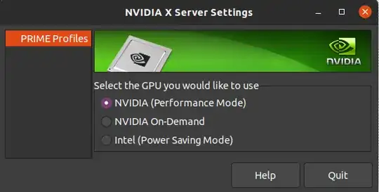

Whenever I run nvidia-settings, I only get one tab option on the left side, which is PRIME PROFILES. There is no other option available to me.
Here is a screenshot of my NVIDIA X Server Settings:
nvidia-settings

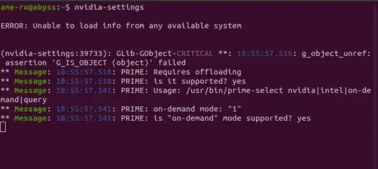

And here is a screenshot from the terminal output of nvidia-settings.
nvidia-settings terminal output

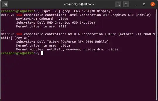

Edit-1: Here's the output of lspci -k | grep -EA3 'VGA|3D|Display'
