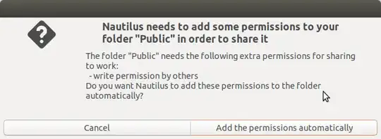

  11. On the dialog that appears, click the Add permissions automatically button.
    Add Permissions Automatically dialog

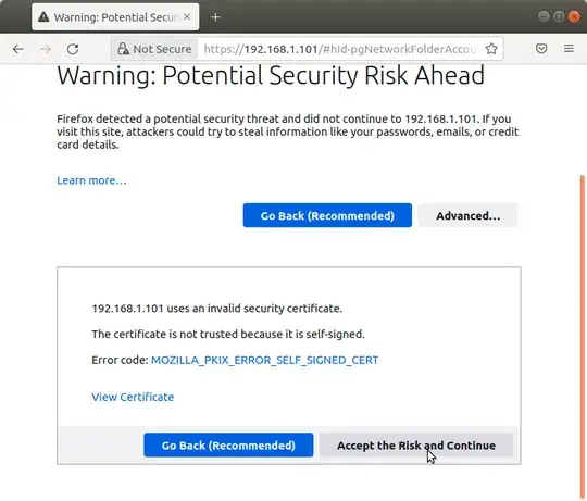

  1. Open a web browser and go to the IP Address of your printer.
  2. You will be presented with the message "Warning: Potential Security Risk Ahead".
  3. Click the Advanced... button.
  4. Click the Accept the Risk and Continue button.
    Potential Security Risk warning

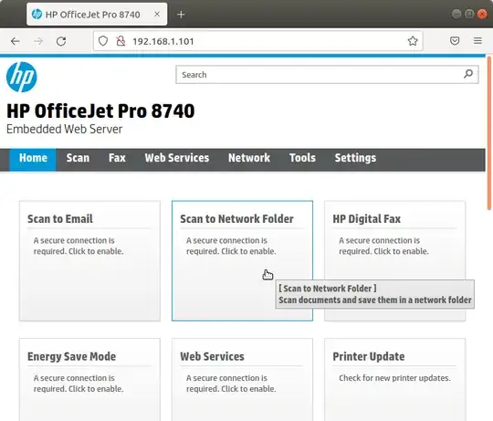

  5. The HP Embedded Web Server page will appear.
Configure Your Printer

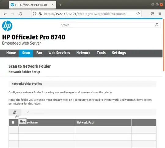

  1. Click to the "Scan to Network Folder" tile.
  2. Click the "+" icon to add a new Network Folder to your printer.
    Scan to Notwork Folder page

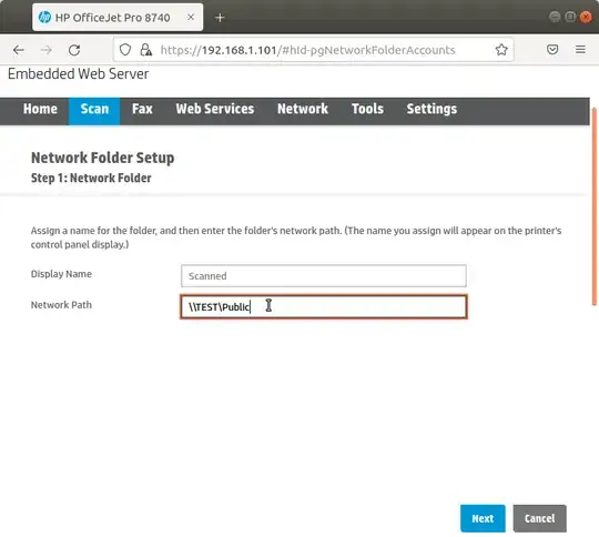

  3. Complete the "Step 1: Network Folder" page.
    1. Enter a display name for your new Network Folder.
    2. For Network Path, type \\<YOUR COMPUTER NAME>\Public.
      Replace <YOUR COMPUTER NAME> with the host name of your computer. In some cases you may need to add .local at the end. You can also use your computer's IP address, if you are using static IP addresses.
    3. Click the Next button.
    Step 1 page

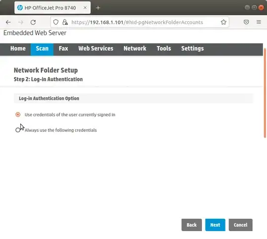

  4. Complete the "Step 2: Log-in Authentication" page.
    1. Click the "Use Credentials of the user currently signed in" checkbox.
    2. Click the Next button.
    Step 2 page
