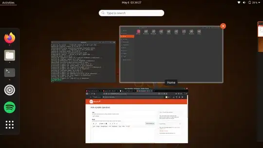

I'm a newbie to ubuntu and was trying to uninstall dash to dock as I don't need it. I uninstalled it using sudo apt remove gnome-shell-extension-ubuntu-dock and the dock still showed up in activities overview. Then I found someone used to sudo apt purge gnome-shell-extension-ubuntu-dock to resolve the issue. I tried, still no luck. And now this big dock shows up in activities overview.Screenshot
It would also be helpful if somecan can help me get the dock back to normal!

I just disengaged Dash to Dock with this link.
https://extensions.gnome.org/extension/307/dash-to-dock/
It had a on\off switch and mine was on and I switched it to off.
