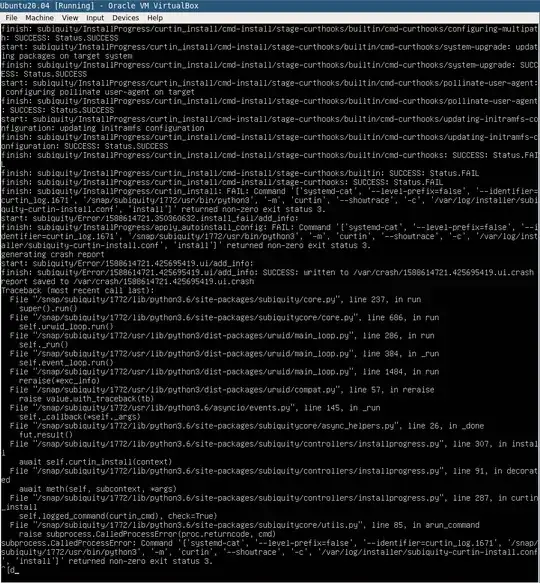

By following instructionf from here https://wiki.ubuntu.com/FoundationsTeam/AutomatedServerInstalls#Running_a_truly_automatic_autoinstall When I use for storage:
storage:
  layout:
It creates root parttition with 4GB and doesn't create swap. When I use direct layout
storage:
  layout:
It creates root partition with full space available on disk and also creates swap. Is there any way to see how it is configured layout direct and modify that configuration to adjust my needs? I mean with action based config like is documented here: https://wiki.ubuntu.com/FoundationsTeam/AutomatedServerInstalls/ConfigReference#storage
I mean something like following:
storage:
  grub:
    install_devices:
      - esp-partition
  swap:
    filename: swap.img
  config:
    - type: disk
      ptable: gpt
      wipe: superblock
      grub_device: true
      match:
    - id: esp-partition # create partitions on disk (like sda1)
      type: partition
      device: disk0
      flag: boot # EFI system partition needs boot flag
    - type: partition
      device: disk0
    - type: partition
      device: disk0
    - id: esp-partition-fs # format partitions on disk
      type: format
      volume: esp-partition
      fstype: fat32
      label: ESP
    - id: boot-partition-fs
      type: format
      fstype: ext4
      volume: boot-partition
    - id: root-partition-fs
      type: format
      fstype: ext4
      volume: root-partition
    - id: esp-partition-fs-mount # mount partitions
      type: mount
      device: esp-partition-fs
      path: /boot/efi
    - id: root-partition-fs-mount
      type: mount
      path: /
      device: root-partition-fs
    - id: boot-partition-fs-mount
      type: mount
      path: /boot
      device: boot-partition-fs
Above configuration SUCCESS pass FileSystem step but FAIL on initramfs step of cloud-init configuration. Like on screenshot enter image description here I would like to know storage configuration for direct layout so I can adjust my configuration above, or if someone know to help me how to fix above configuration so step initramfs pass?
