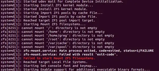

I'm unable to mount rpool after booting:
$ zfs mount rpool
cannot mount '/': directory is not empty
Here's the current ZFS related error when I run journalctl -b: enter image description here

-rw-------  1 root root 399 May  4 12:59 .bash_history
drwx------  4 root root   4 Apr 28  2018 .cache
drwx------  6 root root   6 Jun 23  2018 .config
drwx------  3 root root   3 Apr 28  2018 .dbus
drwx------  2 root root   3 Apr 20 20:01 .ecryptfs
drwx------  2 root root   2 Nov  8  2018 .gconf
drwxr-xr-x  2 root root   3 May  5 07:21 .hplip
drwxr-xr-x  3 root root   3 Apr 28  2018 .local
drwxr-xr-x  3 root root   3 Mar 29 19:01 snap
drwx------  3 root root   6 May  5 06:24 .synaptic
The output of ls -la on /var/cache
$ ls -la
total 142
drwxr-xr-x 18 root root  19 Feb 18 06:30 .
drwxr-xr-x 15 root root  17 Apr 27  2018 ..
drwx------  2 root root  22 Apr 30 13:02 apparmor
drwxr-xr-x  4 root root   4 Dec  6  2018 app-info
drwxr-xr-x  3 root root   5 May  5 06:21 apt
drwxr-xr-x  2 root root   6 Apr 29  2018 cracklib
drwxrwx---  3 root lp    11 May  5 06:31 cups
drwxr-xr-x  2 root root   7 May  5 06:21 debconf
drwxr-xr-x  2 root root 153 Apr 30 13:02 fontconfig
drwxr-xr-x  2 root root   4 May  4 13:05 fwupd
drwxr-xr-x  2 root root   2 Jun  5  2018 gdm
drwx------  2 root root   3 May  2 17:26 ldconfig
drwxr-xr-x 35 man  man   37 May  5 06:21 man
-rw-r--r--  1 root root 227 May  5 05:28 motd-news
drwxr-xr-x  3 root root   3 Sep  3  2018 PackageKit
drwxr-xr-x  3 root root   5 May  5 07:22 samba
drwx------  2 root root   2 Aug 30  2016 slack
drwxr-xr-x  3 root root   6 May  4 15:28 snapd
drwxr-xr-x  2 root root   3 Apr 29  2018 ubuntu-advantage-tools
The output of ls -la on /var/spool
$ ls -la
total 11
drwxr-xr-x  5 root   root  5 May  4 12:26 .
drwxr-xr-x  3 root   root  3 May  4 12:26 cron
drwx--x---  3 root   lp    3 May  4 12:26 cups
drwx------  2 syslog adm   2 May  4 12:21 rsyslog
guttermonk
  • 1,024
You need to remove the redundant, unused mountpoint attribute from the datasets. If rpool (the root dataset) is actually unused, remove the mountpoint attribute and set it on the dataset actually used (rpool/ROOT/ubuntu):
zfs set mountpoint=none rpool
And the most important, you should set the rootfs zpool attribute in addition to set the mountpoint=/ at the dataset level:
zpool set bootfs=rpool/ROOT/ubuntu rpool
Also, is safe to delete the mountpoint directories (ZFS will create them when mounting). Please rename or backup those directories.
If you don't have a rescue disk, you may get the Busybox shell by appending init=/bin/Busybox sh and remove the root= argument in the boot command line arguments. Then, you may import the pool without mounting (zpool import -R /mnt -n rpool), then, edit the attributes as you need.
Finally, never rely on fstab for mounting zfs filesystem datasets (except for zvols like swap), unless you're know what you doing, as datasets with standard mountpoint attribute are mounted early. Use mountpoint=legacy to allow be mounted using mount or trough fstab.
