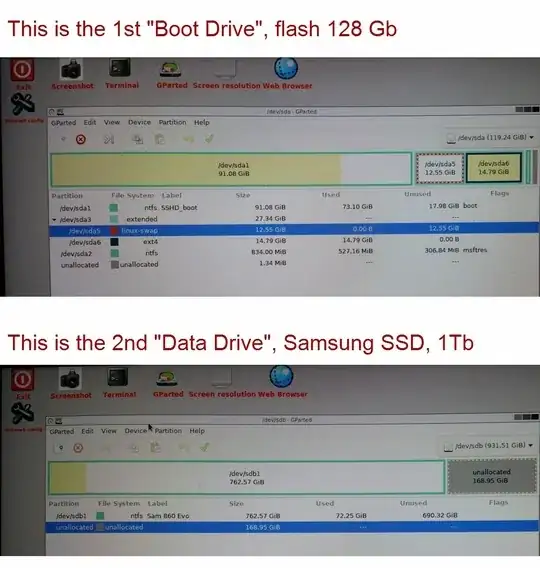

Installed Ubuntu 18.04 64-bit on laptop with 2 drives but installation did not go as planned. While I did make a 169 GB partition on my 2nd drive, Ubuntu didn't use it and stuffed everything: including all data onto the little bitty boot drive. Both OS's were working fine until I discovered Ubuntu was "out of room" to install a necessary application.
System specs are:
drive 1 (boot) a 128 GB flash card which also boots Win-10 using 91.08 GB
       Xubuntu 18.04 {same as Ubuntu but uses the XFCE Desktop rather than Gnome}  27.34 GB
                  mount point /
drive 2 (Also a SSD) Samsung 860 Evo 1TB  with a 762 GB partition for Windows stuff
            and a 168.95  "unallocated block" I believe I made for Ubuntu to use ext4
The following screen shots are from the boot program "GParted" under which I booted my computer (CD). I would like to format the 168.95 GB "unallocated block" to ext4 and add it to Ubuntu which is out of room to run programs. While it would be wonderful to have a separate data partition for Ubuntu to use, I don't know how I can do that.
I guess if I simply format the 168.95 GB block ext4 and add it to Ubuntu under the mount point / then Ubuntu will simply see a lot more room in which to install & run programs?
How can I do that without erasing my Windows or my Ubuntu installations? Link to an earlier related post I made. is my Ubuntu partition full?
GParted illustration of drives
Thanks very much to oldfred. The article he listed did show me how to add a new home using the 180 GB partition on the 2nd or "data drive". The continuation of the thread is here: Ubuntu Moving Home Directory
