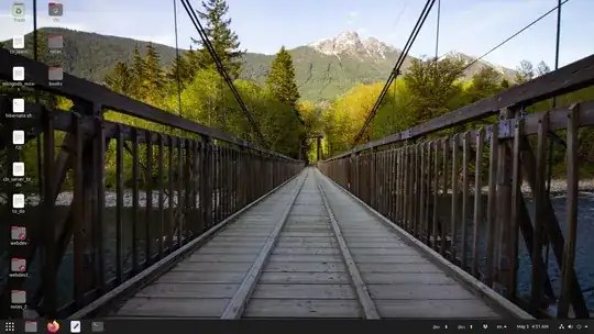

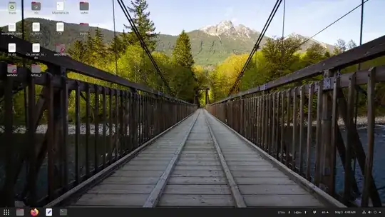

My Desktop icons keep toggling between these two types of arrangement (image attached):
arrangement 1
arrangement 2
I can't really tell what triggers the toggle. It seems like the first type occurs after logging in, and then it switches to the second type when specific actions are done. I tested it by creating a new directory in the Desktop. This sometimes triggers the change, but sometimes not. Sometimes moving the newly created directory to trash seems to trigger it.
Turning on/off the Desktop icons extension does not seem to do anything.
How do I fix this?
Just to note, I am using Nemo as my default file manager.
UPDATE: This was helpful. By removing the Desktop icons extension (apparently by deleting the actual directory of the extension) and making Nemo handle the desktop icons seems to be working fine.
