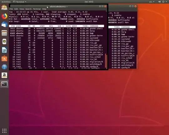

Unfortunately, when I maximize a window, it won't get updated until I switch to another window and back again, or if I move the mouse over the entire window.

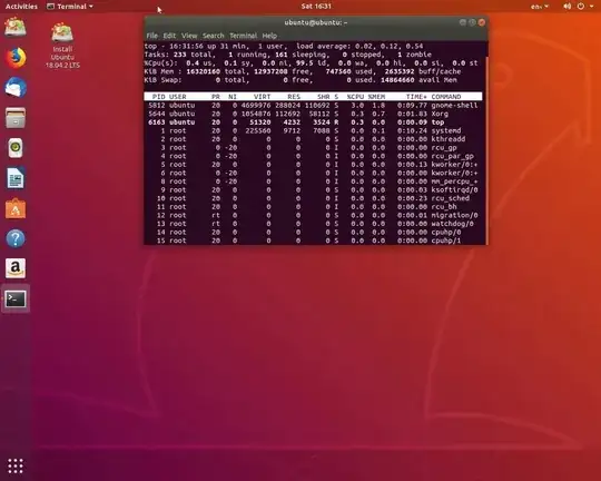

Normal window:
Clutter after maximizing:
