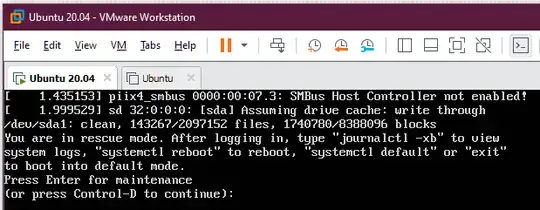

Then I edited grub to enable boot menu, update-grub then systemctl reboot, and use e to edit the default entry. I scrolled down to the first linux line and appended rescue and booted this entry with Ctrl-X, which led to this screen:
rescue mode
Everything seems fine here as I can SSH into this VM right at this point.
