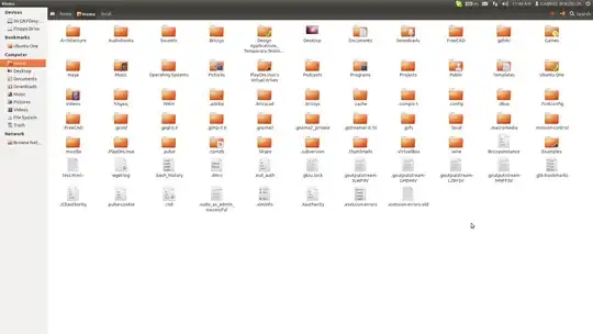

I tried already to find something for my question in [askubuntu.com] , but nothing was answering my needs. So, what i want is build vim as a very powerful and useful editor for html,css, javascript, etc but for programming too. I am trying to learn css and generally I wanted a very nice editor with many plugins. So, can anybody help me, step by step, for customizing vim and about what features to look around that might help me in my learning period?thanks
Oh, and the only way that vim is running is from terminal?thanks
***edit--->I cannot find my.vimrc file
my home folder

Everyone else has excellent advice, I thought I'd fill in with some of the basics:
1. GVim for vim outside the console, and how to install it
You asked whether vim can only be run from the console. GVim (GUI-Vim) is the standalone version. From your screenshot, it looks like you're using Ubuntu, you can find gvim in the Software Centre and install it from there. Alternatively you can sudo apt-get install gvim from a terminal.
