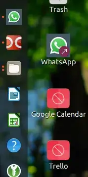

Just installed Ubuntu 20.04 and tried to get my favorite webapps (i.e. Google Calendar, WhatsApp Web) working again. Since Firefox removed this feature years ago, I'm now using Chromium for this. On 18.04 I could just head to my favorite website, click the hamburger menu, 'More tools', 'Create shortcut...', tag 'Open as window' and bam, the WebApp was ready.
In 20.04 on my system with the Chromium Snap however, creating a WebApp sometimes results in Chromium crashing which leaves a .desktop file that does not work. The .desktop file, which is created on the desktop, you then right-click and choose 'Allow Launching'. In most cases, this works and the webapp will get a proper icon and can be launched.
In other cases (i.e. when creating a shortcut from chrome://apps or when creating the shortcut resulted in Chromium crashing), the icon turns into a "faulty" sign:
some work, others don't
When I double-click WhatsApp, it's opened as a 'real' app (as can be seen in the screenshot). When i double-click Google Calendar however, a new empty full Chromium window is opened. And when I double-click Trello (of which the shortcut was created from chrome://apps), a new full Chromium Window is opened (instead of an 'app'-window) but it does lead to trello.com.

Ok, I got this working by editing the file on the desktop to change the Exec line to start to read like this:
Exec=/snap/bin/chromium
Followed by the rest of the parameters.
I fixed the icon by searching for it on the filesystem using a simple brute force:
find . | grep ddiddklncfgbfaaahngklemobghhjkim
Where ddiddklncfgbfaaahngklemobghhjkim is the app id from the desktop file. I found a bunch of icons in /home/$USER/./snap/chromium/common/chromium/Default/Extensions/ddiddklncfgbfaaahngklemobghhjkim/2020.8.12.59739_0/icons so I picked a good looking one and changed the Icon line in the .desktop file to use that. Mine looks like this now:
Icon=/home/rock64/snap/chromium/common/chromium/Default/Extensions/ddiddklncfgbfaaahngklemobghhjkim/2020.8.12.59739_0/icons/256.png
I then saved the file, making sure no additional spurious lines had been added. The first line of the file should read:
[Desktop Entry]
I then right clicked the desktop file on the desktop and chose "Allow Launching". I now have a working launcher.
