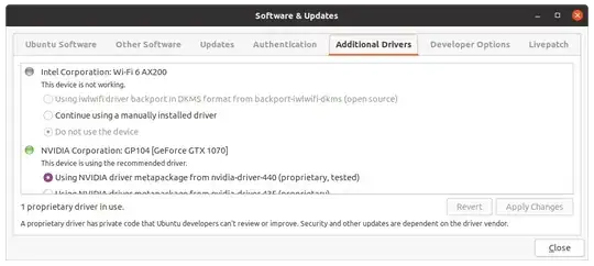

I'm a new user to Ubuntu, but a novice/moderate experienced Linux user. I am getting strange Bluetooth behavior, and I found out my new hardware is Intel chipset that is both Bluetooth and Wi-Fi. However, under Additional Drivers in Software and Updates, the problem only shows up as my Wi-Fi.
The driver backport is completely blacked out. That backport should have fixed the issue, especially since the kernel has compatibility with this Intel chipset.
Also, the Wi-Fi is working fine. Bandwidth tests show it is working at full speed.
Ideas how to troubleshoot from the command line to manually use the driver backport?

Sorry this is not an answer on how to debug bluetooth, but I cannot post comments yet, so I'm giving you these information here.
Intel AX200 is having major problems with linux (for instance, i have the same card and sometimes, on boot, the card stops working and it won't come back to life unless I temporarily disable the battery of my laptop directly from the BIOS)^[1].
According to the answer of this post, what you see on the additional drivers is not actually a real problem.
Nonetheless, if you search for errors with dmsg or with journalctl you will find errors of this kind:
[   44.601884] iwlwifi 0000:52:00.0: Direct firmware load for iwlwifi-cc-a0-49.ucode failed with error -2
If you check this thread, this seems to be a kernel problem, which is trying to load the wrong driver. Recent versions of the kernel (5.5+) seem to solve it, but ubuntu 20.04 is still on kernel version 5.4 and I bet it will not change until the next kernel LTS version (2021?).
I don't think this answers your question, but I really hope it does help you.
[1] You could call it "forced electronic reset", unplugging and re-plugging the wifi card itself works the same, but I have no idea on why I need to do it.
