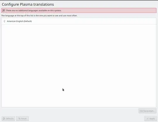

When I accidentally deleted Localizations via BleachBit, in system settings I can't add another language. And this massage pop-up: "There are no additional languages available on this system." How can I fix this?

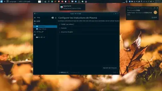

First run sudo dpkg-reconfigure locales from the command line to adjust your locales setting.
Then open the Languages module from the System Settings.
There is an Add language button.
you can order multiple languages in order of preferences. if some translations strings are missing, it will automatically fallback to your next favorite.
you need to logout and log back in after adding languages

I'm getting "There are no additional languages available on this system" too and none of the answers I found on the Internet can solve my problem, only leading me onto the wrong ways. So I think it's worthwhile to log what actually worked for me, ignoring all that didn't work (which were plenty):
Foremost,
  • My system is heavily trimmed and never need any language support previously until now.
  • and I hope to keep it that way -- installing only the minimum packages just to get pass it.
  • In the end, I'm still having such "There are no additional languages available on this system" issue, but I can now manage to have my KDE in another language (Chinese). Please bear it in mind when check the following out.
In short, to have KDE in Chinese
  • sudo apt install -y language-pack-kde-zh-hans
  • Change ./.config/plasma-localerc from
[Formats]
LANG=C
To,
[Formats]
LANG=zh_CN.utf8
That's it!
