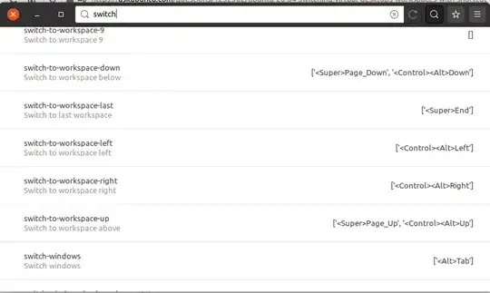

You can change the keybindings with dconf-editor.
Install:
sudo apt install dconf-editor
Run dconf-editor and go to /org/gnome/desktop/wm/keybindings/
Search "switch" and change the settings to your needs:
dconf-editor switch workspace keybindings
E.g.:
['<Super><Control>Right']
