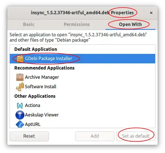

If you're looking for a reliable GUI way to install .deb files, use gdebi.
To see if you already have it installed on your system...
dpkg -l gdebi | grep ii
If it's not there, install it this way...
sudo apt-get update
sudo apt-get install gdebi
Then get the "Properties" of any .deb file, and set the default "Open With" application as gdebi. Now you can just double-click on .deb files to install them.
Note: gdebi may not operate properly if .deb files are on the desktop.

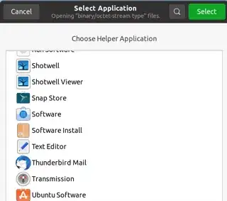

You can install gdebi or similar software as suggested in other answers but there is a workaround to modify the file association to use the other Software Install which is associated with gnome-software:
Firefox
When choosing application to open change for the suggested or default Software Install to the other further down the list. This second one is the gnome-software association.

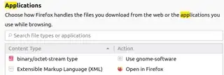

You can verify that it is gnome-software in Preferences->Applications:

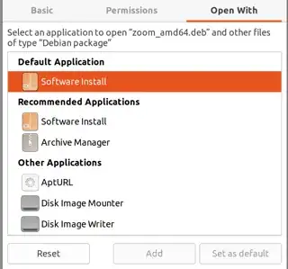

Nautilus
The same can be done within Nautilus by right-clicking and opening Properties for a /tmp/.deb file and switching the Open with from current default Software Install to the other suggestion.
