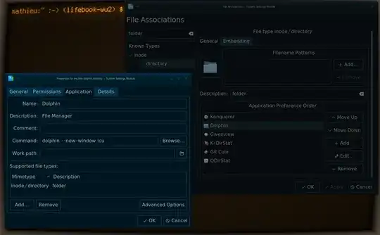

You can go under File Associations and set your favorite application for folder, when choosing Dolphin, you can go in Application properties and add the command line parameter --new-window before the %u
thinking about this, you could have both configure, and have the option to right click -> open with -> dolphin new tab/window
see attached screenshot
file associations settings
