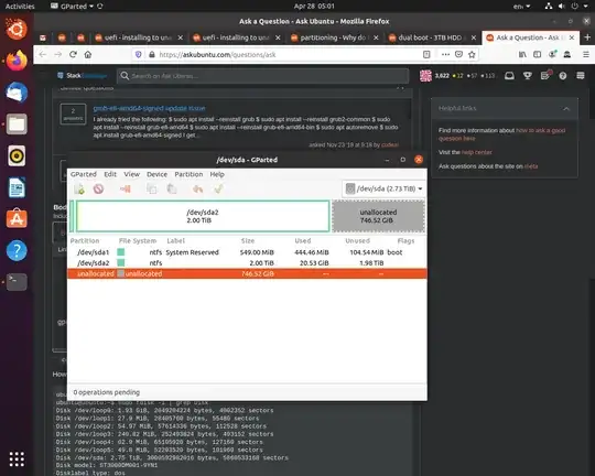

gparted shows:
gparted
where I'm not seeing an option to change the flag...
This has to be change to EFI to dual-boot? Unfortunately, due to licensing, it's not an option to run Windows as VM with just an OEM license (for all practical purposes).
Thufir
  • 4,631
You definetely need a GPT partition table on drives larger than 2.2TB. With the old msdos partition table you are limited to 2.2 TB and can't make use of the full amount of space.
Reference: https://uefi.org/sites/default/files/resources/UEFI_Drive_Partition_Limits_Fact_Sheet.pdf
If you install Windows on a GPT drive, it must be UEFI. Linux generally can be installed in either UEFI-mode or legacy-mode (the latter needs a bios_boot partition).
One more point: You can't mark unallocated space as bootable, unallocated space is not a partition.
