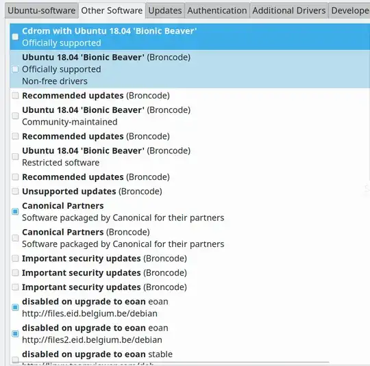

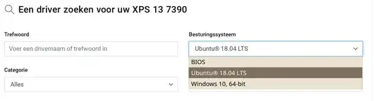

I had XPS-13 9370 with 18.04 installed, accidentally installed 19, and was offered to upgrade to 20.04, which seems to be running more of less fine now on the laptop.
Can someone explain how to add the Dell firmware updates?
I think the solution is somewhere here: http://oem.archive.canonical.com/dists/?C=M;O=D

N: See apt-secure(8) manpage for repository creation and user configuration details.
W: GPG error: http://dell.archive.canonical.com/updates bionic-dell-beaver-three-eyed-raven Release: Detached signature file '/var/lib/apt/lists/partial/dell.archive.canonical.com_updates_dists_bionic-dell-beaver-three-eyed-raven_Release.gpg' is in unsupported binary format
E: The repository 'http://dell.archive.canonical.com/updates bionic-dell-beaver-three-eyed-raven Release' is not signed.
N: Updating from such a repository can't be done securely, and is therefore disabled by default.
W: GPG error: http://dell.archive.canonical.com/updates bionic-dell-service Release: Detached signature file '/var/lib/apt/lists/partial/dell.archive.canonical.com_updates_dists_bionic-dell-service_Release.gpg' is in unsupported binary format
E: The repository 'http://dell.archive.canonical.com/updates bionic-dell-service Release' is not signed.
update: 20.04 is not supported (yet) by Dell:
