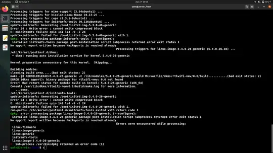

Now when I boot up, the same thing happens as before but when I run sudo apt install to install something (say node js), it doesn't install and throws up errors. The screenshot of the errors:
dpkg: error processing package linux-firmware (--configure):
 installed linux-firmware package post-installation script subprocess returned
error exit status 1
Setting up linux-image-5.4.0-26-generic (5.4.0-26.30) ...
dpkg: dependency problems prevent configuration of linux-image-generic:
 linux-image-generic depends on linux-firmware; however:
  Package linux-firmware is not configured yet.
dpkg: error processing package linux-image-generic (--configure): dependency problems - leaving unconfigured No apport report written because the error message indicates its a followup err or from a previous failure. No apport report written because the error message i ndicates its a followup error from a previous failure. dpkg: dependency problems prevent configuration of linux-generic: linux-generic depends on linux-image-generic (= 5.4.0.26.32); however: Package linux-image-generic is not configured yet.
dpkg: error processing package linux-generic (--configure): dependency problems - leaving unconfigured Processing triggers for gnome-menus (3.36.0-1ubuntu1) ... Processing triggers for libc-bin (2.31-0ubuntu9) ... Processing triggers for man-db (2.9.1-1) ... Processing triggers for dbus (1.12.16-2ubuntu2) ... Processing triggers for desktop-file-utils (0.24-1ubuntu2) ... Processing triggers for mime-support (3.64ubuntu1) ... Processing triggers for hicolor-icon-theme (0.17-2) ... Processing triggers for cups (2.3.1-9ubuntu1) ... Processing triggers for initramfs-tools (0.136ubuntu6) ... update-initramfs: Generating /boot/initrd.img-5.3.0-46-generic Error 24 : Write error : cannot write compressed block E: mkinitramfs failure cpio 141 lz4 -9 -l 24 update-initramfs: failed for /boot/initrd.img-5.3.0-46-generic with 1. dpkg: error processing package initramfs-tools (--configure): installed initramfs-tools package post-installation script subprocess returned error exit status 1 No apport report written because MaxReports is reached already Processing triggers for linux-image-5.4.0-26-generic (5.4.0-26.30) ... /etc/kernel/postinst.d/dkms:
  • dkms: running auto installation service for kernel 5.4.0-26-generic
Kernel preparation unnecessary for this kernel. Skipping...
Building module: cleaning build area.....(bad exit status: 2) make -j8 KERNELRELEASE=5.4.0-26-generic -C /lib/modules/5.4.0-26-generic/build M=/var/lib/dkms/rtlwifi-new/0.6/build...........(bad exit status: 2) ERROR (dkms apport): binary package for rtlwifi-new: 0.6 not found Error! Bad return status for module build on kernel: 5.4.0-26-generic (x86_64) Consult /var/lib/dkms/rtlwifi-new/0.6/build/make.log for more information. ...done. /etc/kernel/postinst.d/initramfs-tools: update-initramfs: Generating /boot/initrd.img-5.4.0-26-generic Error 24 : Write error : cannot write compressed block E: mkinitramfs failure cpio 141 lz4 -9 -l 24 update-initramfs: failed for /boot/initrd.img-5.4.0-26-generic with 1. run-parts: /etc/kernel/postinst.d/initramfs-tools exited with return code 1 dpkg: error processing package linux-image-5.4.0-26-generic (--configure): installed linux-image-5.4.0-26-generic package post-installation script subprocess returned error exit status 1 No apport report written because MaxReports is reached already Errors were encountered while processing: linux-firmware linux-image-generic linux-generic initramfs-tools linux-image-5.4.0-26-generic E: Sub-process /usr/bin/dpkg returned an error code (1)
