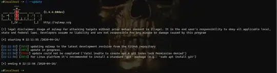

1 --update
Output:
[22:31:53] [ERROR] update could not be completed ('fatal Unable to create opt A git index lock Permission denied')
