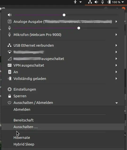

Tested in GNOME 20.04 and working!
First, get sudo systemctl hibernate working (see above answer).
Paste
[Enable hibernate in upower]
Identity=unix-user:*
Action=org.freedesktop.upower.hibernate
ResultActive=yes
[Enable hibernate in logind]
Action=org.freedesktop.login1.hibernate;org.freedesktop.login1.handle-hibernate-key;org.freedesktop.login1;org.freedesktop.login1.hibernate-multiple-sessions;org.freedesktop.login1.hibernate-ignore-inhibit
ResultActive=yes
into /etc/polkit-1/localauthority/10-vendor.d/com.ubuntu.desktop.pkla
Install this GNOME Shell Extension
And voilá, two options appear: * hibernate * hybrid sleep
Proof: enter image description here
I want this to work by default in Ubuntu!
