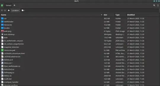

Changing their extension:
Not all appimages have exactly the same structure, but all are archives. Wikipedia says: "An AppImage of version 1.0 is an ISO 9660 Rock Ridge file (which can be optionally zisofs compressed) containing a minimal AppDir and a tiny runtime. (Version 2 may use other file system image formats like SquashFS)".
So, it can be extracted. In this way you can examine the files.
Simply changing the extension from AppImage to an archive extension that my file-roller archive manager can read (I tested with zip, 7z, etc) and double-clicking the file reveals the contents in file-roller:
They can also be extracted, of course. The "extract" file manager context menu action works too in order to extract the archive. (As said in comment, the unzip command reports an error with a file renamed with a zip extension, so renaming to zip is not the proper choice in itself, but it works with archive managers like file-roller.)
