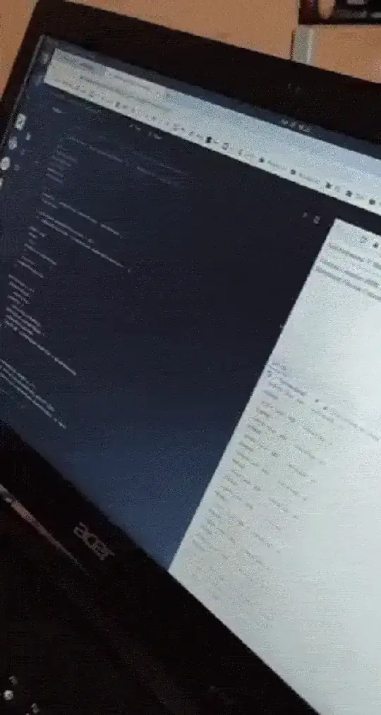

This issue is best illustrated visually, hence I created a recording in the form of an GIF of my laptop screen flickering hectically. The flickering doesn't seem to have a pattern associated with it - it comes and goes on a whim.
It's also important to note that the issue appeared first after the upgrade from 19.04 to 19.10. That's why I decided to refrain from using Eoan in hopes of the issue not being present anymore in future releases like Focal.
The flickering may be barely noticeable but more often than not it is quite intense, hence I find it to be a major issue. After suspending the computer and re-logging the issue disappears for circa 30 seconds.
