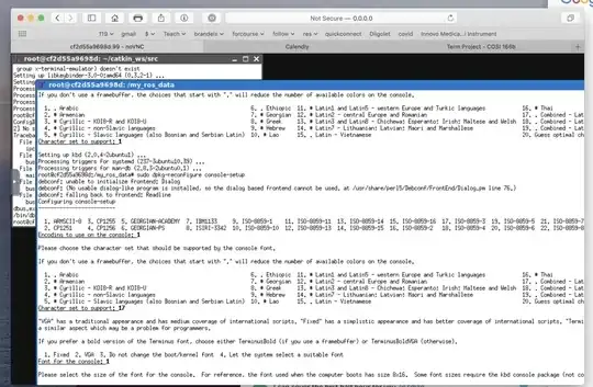

I'm using a docker file that builds an environment for robotics. It works great. I've attached a screenshot. enter image description here
As you can see it has a terminal window and a few other tools but it doesn't seem to have a normal desktop manager, at least I dont recognize it. Which is fine with me. I won't be using it in that mode. But the few times I do use it the font in the terminal window is too small and for the life of me I can't figure out how to do it.
What am I running here? How would I do something like making the font larger? Thanks!

I recognize the xterm icon on those windows. There's a menu that probably offers a few more bitmap fonts in larger sizes, but it's not easily discoverable:
  • Ctrl + right click in the terminal, holding down the mouse button to keep the menu open

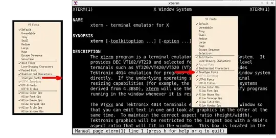

Edit: How to select font and size interactively
So there's no way to change the font of xterm once it's running, you have to do it when it is launched? I'm doing this in a docker image so it's a little convoluted to create that script to intercept the xterm command that is offered when I click on the "desktop".
Is that customizable at all?
Yes, you can modify the font and size interactively:
  • Put the cursor into the xterm window's main area.
  • Press ctrl and right-click to get a pop-up window
  • Move the cursor to select 'freetype' or if installed 'truetype'
  • Move the cursor to select the size you want
You will see tick marks at the selected options.
