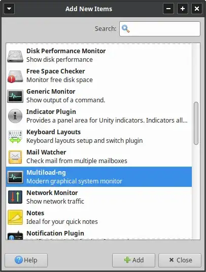

If you don't want to compile by yourself, you can download multiload-ng focal (20.04) binaries to a 22.04 system. It works on my Xubuntu 22.04 desktop. But note that there will be no security updating for these packages.
Download xfce4-multiload-ng-plugin_1.5.2+git20210103-1~webupd8~focal2_amd64.deb and multiload-ng-common_1.5.2+git20210103-1~webupd8~focal2_all.deb from PPA first:
Then install them:
sudo dpkg -i multiload-ng-common_1.5.2+git20210103-1~webupd8~focal2_all.deb
sudo dpkg -i xfce4-multiload-ng-plugin_1.5.2+git20210103-1~webupd8~focal2_amd64.deb
Also install missing dependencies:
sudo apt install -f
After the installation, you will see Multiload-ng item in "Add New Items" from "Panel Preferences":
Multiload-ng item
