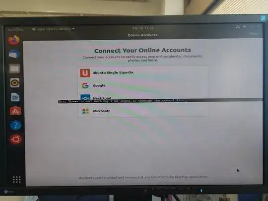

I was having the same issue with a fresh ubuntu installation. I logged in from the terminal pressing Ctrl+Alt+F4 Then I followed the instructions to create a new account Link with a new name [Solved
Things that did not work:
  • Reinstall ubuntu
  • apt install update upgrade etc
  • Install Nvidia toolkit and drivers
