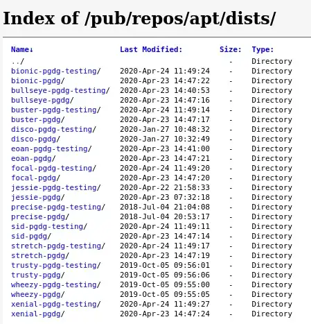

Verified focal shows up at apt.postgresql.org:
Kind of stumped after that as to what to do.
Suggestions?
