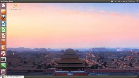

I've recently updated and found that Unity shows on the gnome-classic/fallback desktop. Is this a new feature (which I doubt to be), or a bug? If it is a bug, tell me how to disable Unity because it interferes with the lower panel (i.e. I bring out Trash instead of showing the desktop when I try pressing the "Show desktop" button when the panel is not in focus).
I don't encounter this problem in gnome-classic (No effects).
Don't judge me. I like pokemon!
Screenshot of Unity and GNOME Classic running at the same time

The difference between Gnome Classic and Gnome Classic (no effects) is that the former runs Compiz. It seems Compiz has a Unity plugin, which if enabled, will bring forth that panel and menubar that is annoying you. See this link I found on the Ubuntu forums. The poster there used CCSM to disable the plugin. I don't know if that's the best way (CCSM doesn't have a great reputation, to say the least). You can search this site for alternatives to using CCSM.
