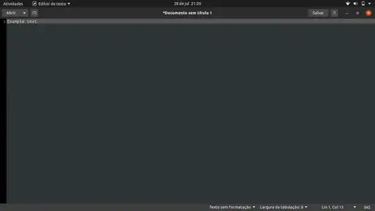

I am unable to see what I type in the Gedit editor using dark theme.
Gedit problem showcase
This is due to the default setting of highlighting the current line.

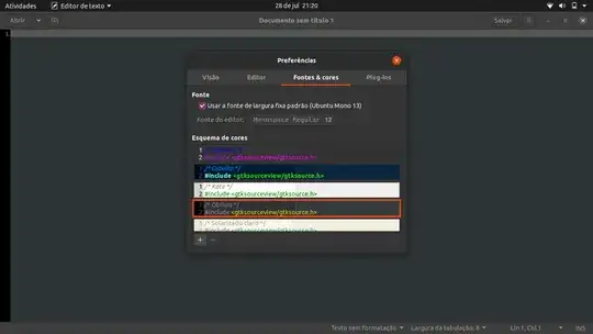

Go to the Preferences menu on Gedit and change the Color Scheme on Fonts & Colors tab:
Color Scheme on Preferences menu
Check if the text is now comfortably readable even with the presence of the highlighted content on the selected line.

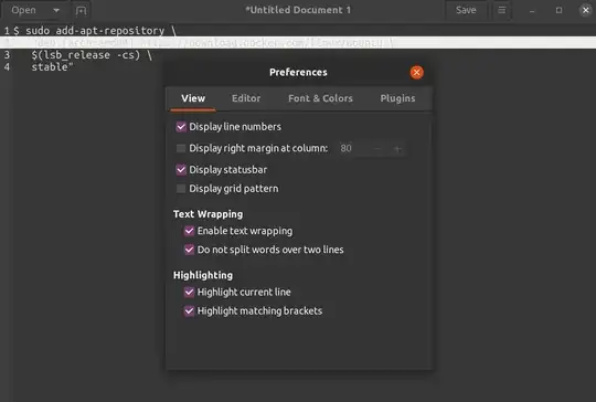

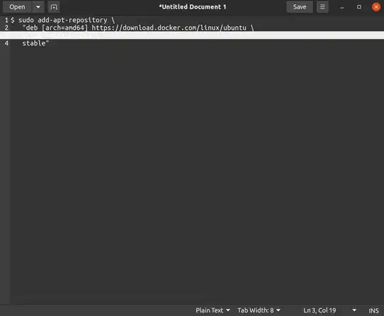

As you can see in the images, by default the Higlight current line feature is enabled in Gedit editor on Ubuntu 20.04 LTS (Focal).
Due to that, you can't see what you type in the current line properly, since the font color and highlight color are almost the same.
You can disable Highlight current line in the preferences of Gedit or change the color of the text in Font & Colors settings.
