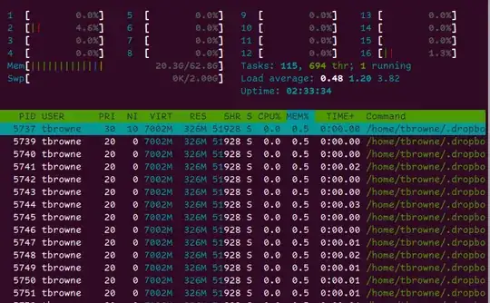

I have 64GB installed but htop shows 20GB in use:
Running ps aux | awk '{print $6/1024 " MB\t\t" $11}' | sort -n gives me the largest processes using only a few 100 megabytes and adding up the whole output only gets me to 2.8GB (ps aux | awk '{print $6/1024}' | paste -s -d+ - | bc). This is more or less what I was getting with Ubuntu 19.04 from which I upgraded yesterday - 3 to 4GB used when no applications are running. So why is 20GB in use on htop?
Now it's true that I have installed ZFS (total 1.5 GB of SSD drives, in 3 pools, one of which is compressed), and I've been moving some pretty big files around so I could understand if there was some cache allocation. The htop Mem bar is mostly green which means "memory in use" as opposed to buffer (blue) or cache (orange) so it's quite concerning.
Is this ZFS using up a lot of RAM, and if so, will it release some if other applications need it?

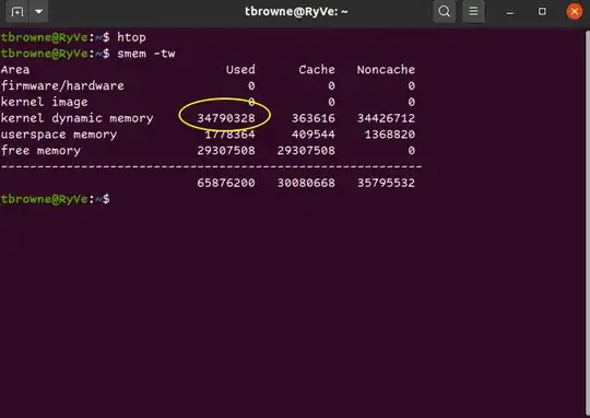

So it's "kernel dynamic memory" that's the culprit. Why so much?
EDIT 2 --> seems to be linked to huge file creation
I rebooted and RAM usage was circa 5GB. Even running a bunch of tags in firefox, running a few VMs, taking RAM up to 20GB, then closing all the applications it dropped back to 5GB. Then I created a big file in Python (1.8G of random number CSV), then concatenated that to itself 40x to produce a 72GB file:

Now after it's all done, and nothing running on the machine, I have 34G in use by the kernel!

ZFS will cache data and metadata so given a lot of free memory this will be used by ZFS. When memory pressure starts to occur (for example, loading programs that require lots of pages) the cached data will be evicted. If you have lots of free memory it will be used as cache until it is required.
You can use the arc_summary tool to see the resources used by the ZFS ARC (adaptive replacement cache)
By default, up to 50% of the system RAM is allocated to ZFS on Ubuntu 20.04. ZFS releases RAM if needed by other processes but it takes some times. For example, I experimented some freezes on Virtualbox VM's because of that.

max
  • 445
ZFS's cache called ARC is being counted as application memory (green bar in htop),
instead of cache (yellow bar in htop).
This is a known bug https://github.com/openzfs/zfs/issues/10255
caused by some difficulties in early implementation.
Even though it looks like application memory, it behaves like a cache
(it will go down in case of memory pressure),
so there is no need to worry about it.
