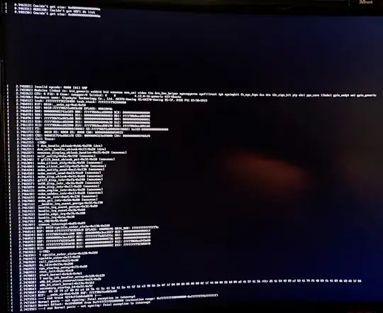

I also tried Boot Repair liveUSB (tested working on another machine):
Unable to handle null pointer dereference at #
Oops: 0002 [#1] SMP
Tainted 4.13.0-16-generic ubuntu (& lots more output)
Kernel panic, not syncing, fatal exception in interrupt, shutting down cpus with MMI
Trying BootRepair with ide=noidma:
screenshot1

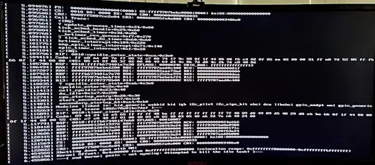

Trying BootRepair again with default settings, says BootRepairDisk for a second in blue then:
screenshot2
(A bit part of why this bug report/help request is such a nightmarish mess is that the error message is regularly different the second time I do the same thing).

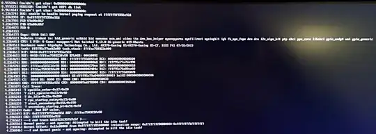

Same again, blackscreen, no output, twice. Power cycled. Again, back to default error:
Screenshot3

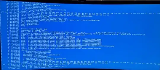

Retrying default ubuntu, which has these settings:
Screenshot4

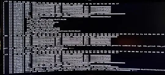

Results in the "attempted to kill init" flavour of init fail:
Screenshot5

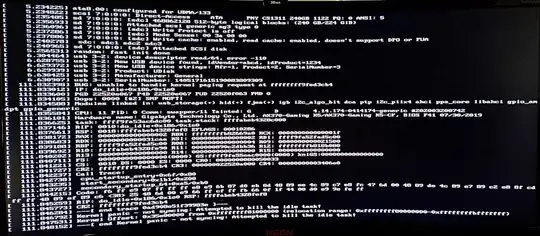

Default ubuntu, safe mode ("kill idle task" fail):
screenshot6

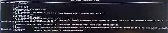

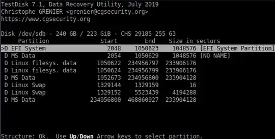

I bought a SATA connector, plugged the SSD (which is the booter for linux & win10 on 2 partitions) into my working laptop, backed up files, and can investigate the drive. But I'm not really sure what I'm looking for in terms of signs that things are wrong. grub.cfg's root UUID matches the drive name listed in Thunar. /sbin/init is a symlink to lib/systemd/systemd which doesn't open with mousepad for investigation. No reason to assume this is 'wrong'? With gparted I can 'check' the boot partition: check and repair filesystem (fat32). Not sure whether this is a good idea? Did it, performed fine. Ran TestDisk:
testdisk
Looks fine? Installed Boot Repair, but it doesn't look like there's an option to analyse the secondary drive's boot sector, and I don't want to risk messing with my laptop's boot sector. Pastebin for boot-repair check. Perhaps the most important looking bit:

However the UUID that I believe the boot process is looking for is aeb0822c-0854-4d06-aa9d-33986c319666 which is sdb2, the xubuntu partition, and NOT 34CA-81B4, the sdb1 boot partition. But I could be, and probably am, 100% wrong about this. But sdb1's grub says to look for the long UUID on sdb2 so that's probably fine.
