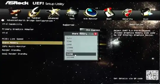

This hint is for those that tried all the other suggestions without success.
The same problem described in this question happened to my old PC when I installed Ubuntu 20.04 on April, 2020. In my case the motherboard was configured to preallocate memory to the internal graphics card automatically. I solved the problem by changing it from "AUTO" to "512 MB". I don't know why changing the shared memory for internal Intel graphics made the dedicated Nvidia card work, but it just worked.
Look at this screen photo:
Asrock UEFI Setup Utility
This is the result of free:
$ free --kibi
              total       usada       livre    compart.  buff/cache  disponível
Mem.:       7593116     2044328     3772060      136516     1776728     3915140
Swap:      20180540           0    20180540
My old machine: ASRock H61M-HG4, i5-3330, 8GB RAM, GeForce GTX 1050 2GB.
