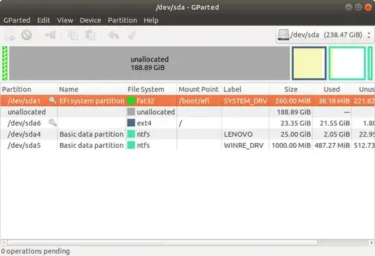

I installed dual boot and decided to remove to windows partition. I used gparted to do this. As you can see in the image I have some allocated space now. My question is, whether it is possible to extend the sda6 partition into the uncatalogued space. The problem is that I can't move anything around and there is now option to extend it using the resize/move option.
Screenshot gparted

First you need to boot from a liveUSB and use gparted to resize the partition.
As an alternative consider simply creating another partition in the unallocated space and use it maybe as a home partition. More information on how to do this here.

Make sure that you have a good backup of your important Ubuntu files, as this procedure can corrupt or lose data.
Keep these things in mind:
  • always start the entire procedure with issuing a swapoff on any mounted swap partitions, and end the entire procedure with issuing a swapon on that same swap partition
  • a move is done by pointing the mouse pointer at the center of a partition and dragging it left/right with the hand cursor
  • a resize is done by dragging the left/right side of a partition to the left/right with the directional arrow cursor
  • if any partition can't be moved/resized graphically, you may have to manually enter the specific required numeric data (don't do this unless I instruct you to)
  • you begin any move/resize by right-clicking on the partition in the lower pane of the main window, and selecting the desired action from the popup menu, then finishing that action in the new move/resize window
Do the following...
Note: if the procedure doesn't work exactly as I outline, STOP immediately and DO NOT continue.
  • boot to a Ubuntu Live DVD/USB, in “Try Ubuntu” mode
  • start gparted
  • move the /dev/sda6 partition all the way left
  • resize the right side of /dev/sda6 to the right, to the desired size
  • click the Apply icon
