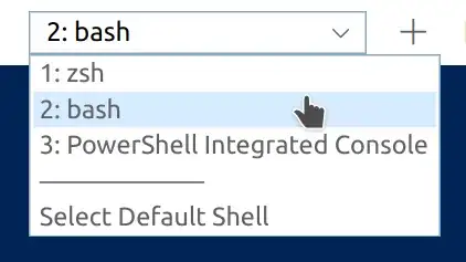

Bash Code
From the run option in your integrated terminal, change the option to be the shell type you want to run your code in.
You can create multiple terminals open to different locations and easily navigate between them. Terminal instances can be added by clicking the plus icon on the top-right of the TERMINAL panel or by triggering the Ctrl+Shift+` command. This action creates another entry in the drop-down list that can be used to switch between them.
More information on the integrated terminals here.
