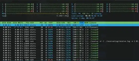

screenshot of htop
Here you can see the kswap process maxing out the CPU. Which many people have come across before.
