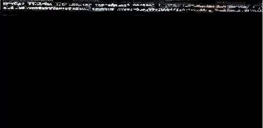

I am trying to install Ubuntu on an old Toshiba 64x laptop that I never used. When I put in the USB drive which works on other computers rather than loading the Ubuntu installation page, it just shows a black screen with white lines of varying sizes. I have already turned off Secure Boot.
black screen

My problem was fixed when loading it from CSM boot rather than UEFI boot. I don’t know why it worked, but after one or two error messages it began the Ubuntu installation
