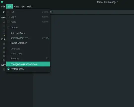

On Thunar, click on edit->Configure custom actions...

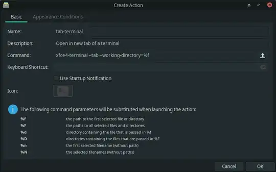

Create new action by clicking on + and fill as given below.
Give the command as:
xfce4-terminal --tab --working-directory=%f
Set an icon of your choice.
In Appearance Conditions tab, check Directories.
and Save. enter image description here

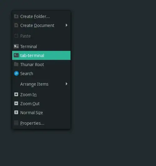

You should get it on your right click menu:

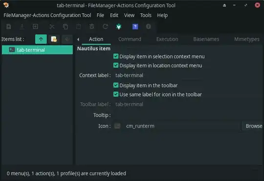

Open filemanager-actions
Create a new action.
Choose an icon, check all those options.

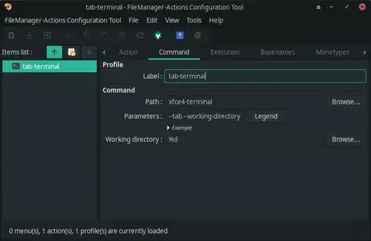

set path as xfce4-terminal
and parameters --tab --working-directory="%d"
and save.

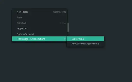

It should show up on your right click menu like this:
