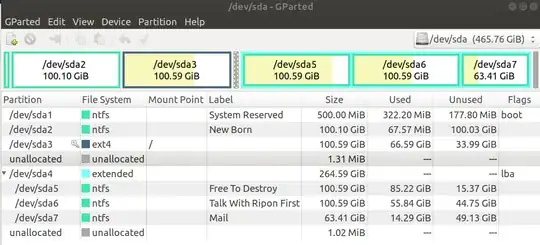

GParted Screen capture:

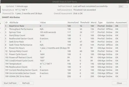

Disks smart data & self tests:
