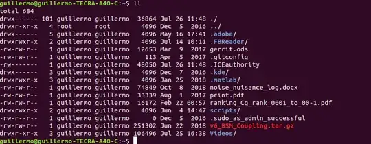

After upgrading from Ubuntu 16.04 to 18.04.2 LTS I find only handful of my home directory contents when using the terminal (natutils sees them fine). Basically only Videos/ and a few files
. However the files and folders are all still there. Autocomplete does not work if I start typing Documents/, but if I do ls Documents/ the content is all there.
Have been able to work around this since I know most of my $HOME/* folders and important files off by heart. Wanting to use du or rsync for the content in my home folder is basically impossible.

which is not showing the content of Documents or tons of other folders and files:
guillermo@guillermo-TECRA-A40-C:~$ du -hs $HOME/Documents
6.1G /home/guillermo/Documents
To further illustrate the severity:
guillermo@guillermo-TECRA-A40-C:~$ mkdir $HOME/folderexists
guillermo@guillermo-TECRA-A40-C:~$ ll $HOME | grep folderexists
guillermo@guillermo-TECRA-A40-C:~$ sudo ls $HOME | grep folderexists
guillermo@guillermo-TECRA-A40-C:~$ cd $HOME/folderexists
guillermo@guillermo-TECRA-A40-C:~/folderexists$ pwd
/home/guillermo/folderexists

I should also note that the $HOME directory is encrypted so I wonder if there is wonkyness going on in the mount.

guillermo@guillermo-TECRA-A40-C:~$ /bin/ls -lah
total 752K
drwx------ 113 guillermo guillermo 44K Apr 16 10:51 .
drwxr-xr-x 5 root root 4.0K Aug 16 2019 ..
drwx------ 5 guillermo guillermo 4.0K May 16 2019 .adobe
-rw-r--r-- 1 guillermo guillermo 1.6K Aug 6 2019 .davmail.properties
-rw-r--r-- 1 guillermo guillermo 3.6K Jul 28 2019 dungeon.txt
drwxrwxr-x 2 guillermo guillermo 4.0K Jul 14 2019 .FBReader
-rw-rw-r-- 1 guillermo guillermo 13K Mar 9 2017 gerrit.ods
-rw-rw-r-- 1 guillermo guillermo 113 Apr 5 2017 .gitconfig
-rw------- 1 guillermo guillermo 72K Apr 14 09:13 .ICEauthority
drwx------ 3 guillermo guillermo 4.0K Dec 7 2016 .kde
drwx------ 3 guillermo guillermo 4.0K Jan 16 11:39 .launchpadlib
drwxrwxr-x 3 guillermo guillermo 4.0K Jan 25 2018 .matlab
lrwxrwxrwx 1 guillermo guillermo 34 Feb 26 12:45 .mbsyncrc -> /home/guillermo/.emacs.d/.mbsyncrc
-rw-rw-r-- 1 guillermo guillermo 74K Oct 8 2018 noise_nuisance_log.docx
-rw-rw-r-- 1 guillermo guillermo 33K Aug 1 2017 print.pdf
drwxr-xr-x 8 guillermo guillermo 4.0K Feb 19 09:05 pyenv3
-rw-rw-r-- 1 guillermo guillermo 16K Feb 22 2019 ranking_Cg_rank_0001_to_00-1.pdf
drwxrwxr-x 2 guillermo guillermo 4.0K Jun 4 2019 scripts
-rw-r--r-- 1 guillermo guillermo 0 Dec 5 2016 .sudo_as_admin_successful
-rw-rw-r-- 1 guillermo guillermo 246K Jun 22 2018 v6_BSM_Coupling.tar.gz
drwxr-xr-x 4 guillermo guillermo 104K Feb 5 23:10 Videos
