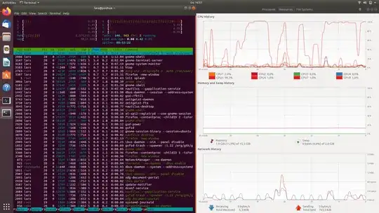

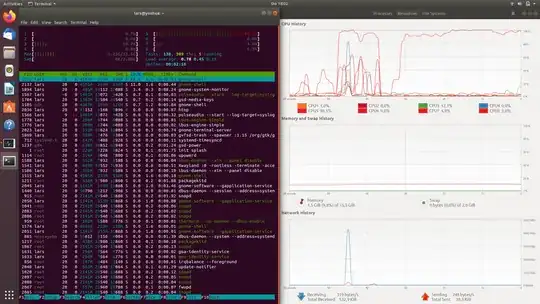

EDIT2:
Pictures of htop after fresh install: Xorg gnome-shell

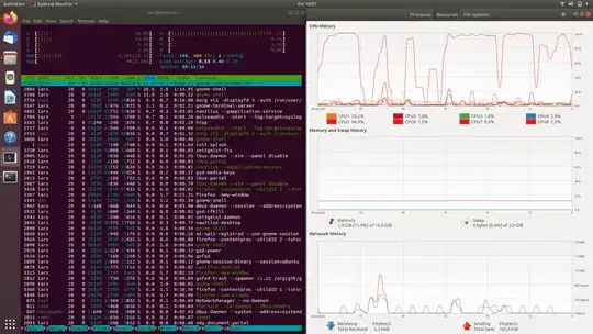

EDIT: usage with ubuntu on wayland Htop on Ubuntut on Wayland
