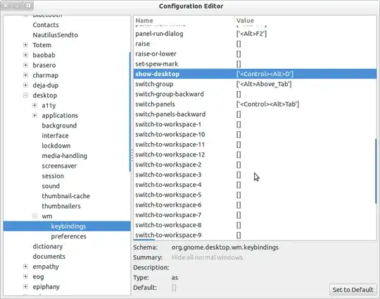

And, for the other one, you need to have dconf-tools Install dconf-tools installed to enable the shortcut for show-desktop.
Open dconf-editor, navigate to orggnomedesktopwmkeybindingsshow-desktop → Change the value to '<Control><Alt>D'.
If you want other options to use the native shortcuts as well, look for them in the dconf-editor in the sub options mentioned above and modify them accordingly.
