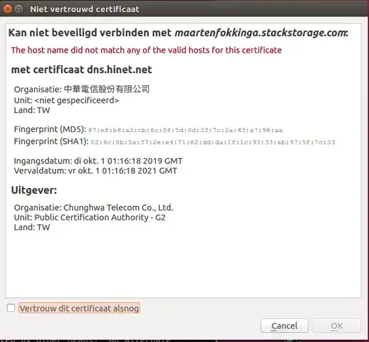

Since a few weeks a pop-up window appears (sometimes) after start-up of my Ubuntu 16.4 system, see this picture: image of pop-up window entitled Untrusted certificate
The title in the window bar says: "Untrusted certificate". The 1st line in the window says: "Cannot safely/securely connect to ....". The company to which ...stackstorage.com belongs, says that it does not use this certificate, and that from their perspective everything is okay. They say that my system might be under MITM-attack. I have no idea what to do (and what the danger is). Please help!

Checking the hostname on mxtoolbox and ssltools.digicert confirm its down the chain from Chunghwa...

Following @Wiper I deleted in Firefox>Preference>Privacy&Security>Certificates>View Certificates...>tab Authoroties the certificate authority ChuChunghwa Telecom Co., Ltd. (ePKI Root Certification Authority --- Builtin Object Token). Also I have reset to factory settings my modem/router, since internet connection in our house was broken several times a day.
These two together seemed sufficient: no problems anymore. (But now I've also done a fresh install of Ubuntu 20.04.)
