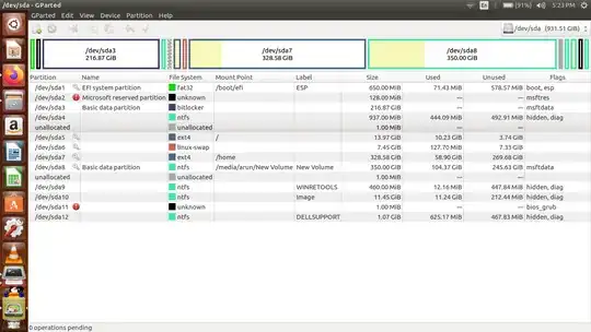

Gparted shows that I've used up 58.90 GB of the 350 GB but that's not true.
Here is the screenshot of GParted: enter image description here

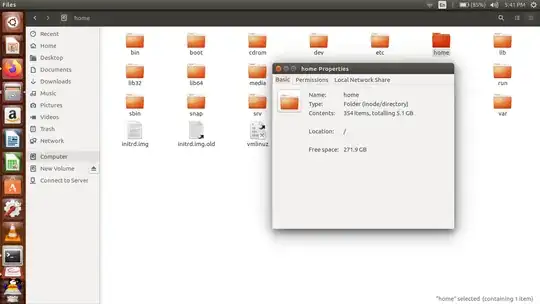

Here is the screenshot of 'properties' of /home folder: enter image description here

Everything is in order. Your /home is on a separate partition and does not fill space on /. Your home has 54G of data.
The problem here is, that Nautilus does not count hidden files even if you show them using Ctrl+h. I would consider this a bug, it was already asked before.
You need to go to Preferences and check "Show hidden files"
Show hidden files
Then your directory size in the preferences will be correct.
