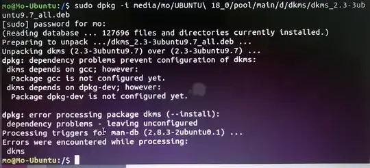

One of the first methods that I tried was suggested here, where the top-voted answer suggests using commands:
sudo dpkg -i /media/username/volname/pool/main/d/dkms/dkms_*.deb
sudo dpkg -i /media/username/volname/pool/restricted/b/bcmwl/bcmwl-kernel-source_*.deb
I get the following error:
As it says packages like dpkg-dev, gcc are not installed/configured.

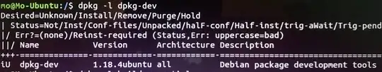

Just to confirm I check if a particular package is not installed using:
dpkg -i dpkg-dev
And I get the following result:
I don't understand the result entirely but it seems dpkg-dev is installed but not correctly.

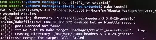

I have also tried downloading driver my Realtek Semiconductor Co., Ltd. RTL8723DE 802.11b/g/n PCIe Adapter Wireless (git project) and installing it using make as instructed on this page.
I get the following error when I use make:
and using dkms doesn't work either.

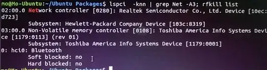

Following is the output of lspci -knn | grep Net -A3; rfkill list:
