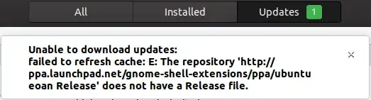

I'm getting this error:
Unable to download updates: failed to refresh cache: E: The repository 'http://ppa.launchpad.net/gnome-shell-extensions/ppa/ubuntu eoan Release' does not have a Release file.

You have the answer in the packages section.
This PPA currently publishes packages for Cosmic, Bionic, Artful, Zesty, Yakkety, Xenial, Wily, Vivid, Utopic, Trusty, Saucy, Raring, Quantal, Precise, and Oneiric.
