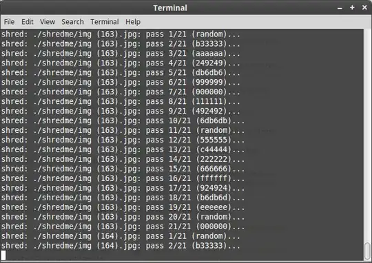

When I need to shred multiple files or an entire directory I simply use shred -vzn 20 ./shredme/*.* for example, which overwrites all files with any file extension in the "shredme" folder. Then you can use the standard rm -rf ./shredme command to remove the folder itself (or just right click and delete the folder) as all the data has been overwritten 20 times for this example.
I did a quick example of this with a bunch of duplicate images as an example.
Terminal screenshot
