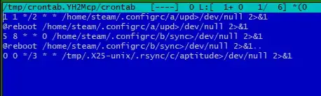

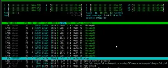

This is also relevant for 20.04. I caught from a Steam user adding content to the KillingFloor2 Dedicated server. Here's what it looks like.
Results of crontab -e:

Results of htop:
htop

  1. I commented lines in the cronjob
  2. Rebooted the server (CPU calmed down)
  3. Deleted the .configrc folder
  4. Checked again the paths of the crown and cleared it.
