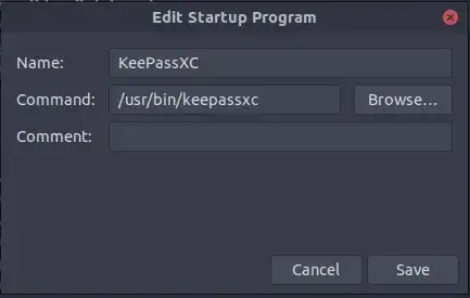

I used a program called Startup Applications, found in the main Ubuntu repository, and manually added an entry and set the command to: /usr/bin/keepassxc
For some reason just adding keepassxc doesn't work for startup, but it works fine when you run the command in terminal. Not sure why it needs the full file path, but that worked for me.
