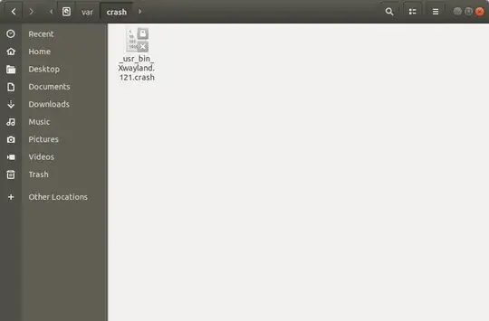

I've got a little touchscreen netbook. It's a little dated. It's a Toshiba Satellite NB10t-A, Model #PU141C-02Y020. I've upgraded its' hard drive to a 250GB Western Digital Blue SSD, and I've maxed out this poor little Bay Trail processor's RAM to 8GB. It's actually pretty good now, considering it only has a 2.2 GHz dual-core. It used to run Win10 (prior to my hardware upgrades), and it was really struggling with just 4GB of ram - so I installed Ubuntu 18.04. The performance gains were encouraging, so I went through with the hardware upgrades and reinstalled. In both instances, I ran into a System Software Problem detected notification. enter image description here
I was hoping someone here could give me hand getting a grasp on what the problem might be. It would be a fun challenge to get it resolved. It doesn't cause the system to fail, but something is crashing upon startup.
I saw some good information in another post (below). Another similar thread, click here
But I think I'm going to need a hand with this one. I have no real coding knowledge but I'm a little familiar with Terminal. If there's anything the community could talk me through - I'm kinda stuck indoors atm! How would I go about getting the contents of my crash folder in front of the community? enter image description here

You may have a problem with an older computer, with an older GPU. Try this...
sudo -H gedit /etc/gdm3/custom.conf # edit this file
change:
    #WaylandEnable=false
to:
    WaylandEnable=false
Save the file and quit gedit. Then reboot.
