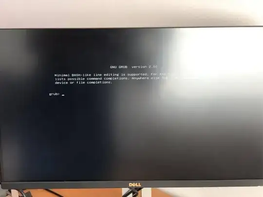

I mostly use Ubuntu now, 99.99% of the time, but I’d still want to keep the Windows installation around. I have the BIOS set to look for the USB medium first and then the SSD, however if the power fails or a restart is needed, I’m greeted with
this grub screen which I can’t access remotely

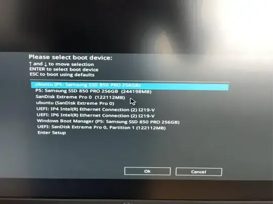

Apparently all I can do is go physically at the machine, type reboot and then spam the F8 key at startup to give me
this Grub screen with the options needed
In this case I just press enter and Ubuntu starts to boot.
I’d like to avoid that first screen, which appears for an unknown reason to me. Maybe Grub doesn’t know where to look.... I don’t know.

You may want to run Boot-Repair, a program that repairs GRUB installations. It works from a bootable USB drive or from an installed Ubuntu system.
